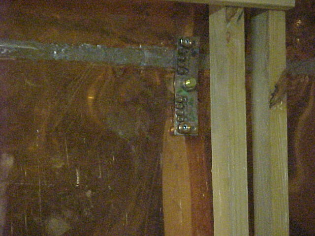

Re: Medical Equipment Grounding question
Pierre, here are some pictures of the single point grounding.
The first two pictures are inside the room, this bar is located below the RF filters, the EGC's will leave a jbox at the filters and land on this bar
This next picture is on the outside of the room where a connection to the building EGC will take place.
Roger
