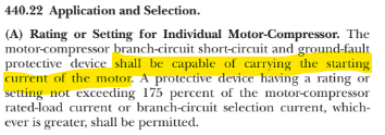

Minimum current ampacity
Unless you are controlling the outdoor temperature and the supply voltage during your testing, no matter how hard you try you are not forcing the worst case operating conditions that the MCA has to account for.

Why not just use the nameplate amps and stop trying to reengineer everything. This way any eventual replacement device can be compared to the original and its wiring, without someone trying to figure out what assumptions you made.
IMHO in this case the 'worst case' we are discussing is the maximum current drawn at the worst extreme of normal operation. Note: this is my assumption/guess.
So the lowest still in tolerance voltage, not a random brownout voltage, and the worst combination of rated outdoor temperature, indoor temperature, and required BTU/hr.

I believe you can put in whatever minimum size OCPD you want. The MCA is about the conductors.
My point was the nameplate values are what they are, there is no point trying to justify them.
- 440 states how you can find what they gave you if you do the math— all I was saying is I bet they just through a number out such as I would for a 100 amp service and just put in 200 just cause it’s the norm around here-
I did not say I was going to do the math and fight it I just wanted to do it and I bet it’s lower by alot
