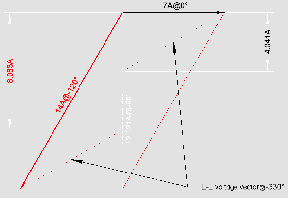

For 120/208 1? 3W, both loads on, you will have to calculate IN = √(I1? + I2? – I1?I2) to determine VDN. Then determine voltage drop per conductor—VD1, VDN, VD2.
Then determine voltage drop per load:
VD1 + VDN ? I1 ? (I1 + I2) = VDTOTAL Load 1
VD2 + VDN ? I2 ? (I1 + I2) = VDTOTAL Load 2​
Note drawing. Calculation below is shortcut for determining Neutral current respective of load.
IN ? I1 ? (I1 + I2) = 4.041A
IN ? I2 ? (I1 + I2) = 8.083A
4.041A + 8.083A = 12.124A​
Since R is a constant in the formula VD = I ? R, VD and I are directly proportional. So...
VDN ? I1 ? (I1 + I2) = VDN Load 1
VDN ? I2 ? (I1 + I2) = VDN Load 2​
As best I can determine, this method yields the correct result, but it needs verified.

The current in the neutral could be determined by SQRT((A*A+B*B+C*C)-(A*B+B*C+C*A)) = 12.12 (in this case).
14*14=196 + 7*7=49 + 0*0=0 all summed up = 245
14*7=98 + 7*0=0 + 0*14=0 all summed up = 98
245 - 98 = 147
SQRT(147) = 12.12
Total current in the ungrounded conductor are 14+7=21 amps.
14 is .6667 of 21
7 is .3333 of 21
12.12 neutral amps * .6667 = 8.084 CKT1 neutral amps
12.12 neutral amps * .3333 = 4.040 CKT2 neutral amps
If, VD=I*R, then:
CKT1 hot side: VD=14*(1.93*(100/1000))=2.702
CKT1 neutral side: VD=8.084*(1.93*(100/1000))=1.560
Total VD for CKT1 is 2.702+1.560= 4.262
CKT2 hot side: VD=7*(1.93*(100/1000))=1.351
CKT2 neutral side: VD=4.040*(1.93*(100/1000))=.7797
Total VD for CKT2 is 1.351+.7797= 2.131
% drop for CKT1 is 4.262/120= 3.55%
% drop for CKT2 is 2.131/120= 1.78%
