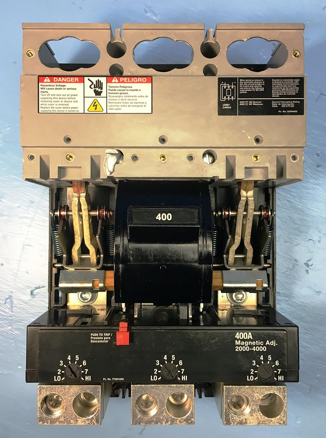

Are you aware of the GE Tri-Break line of MCCB's? I have used a lot of them and they might be just what you are looking for. While it is possible to replace fuses they don't make it easy on purpose and it could very well void UL rating. Not even sure if they still make them. If not maybe someone has something like them.
I couldn't say what causes an electronic breaker to fail. I would be more inclined to suspect high voltage than low. Some, with outboard modules can be repaired (usually larger draw-out types). If obsolete there are places like Satin America that have retrofits. Others, like Micrologic, you toss in the trash.

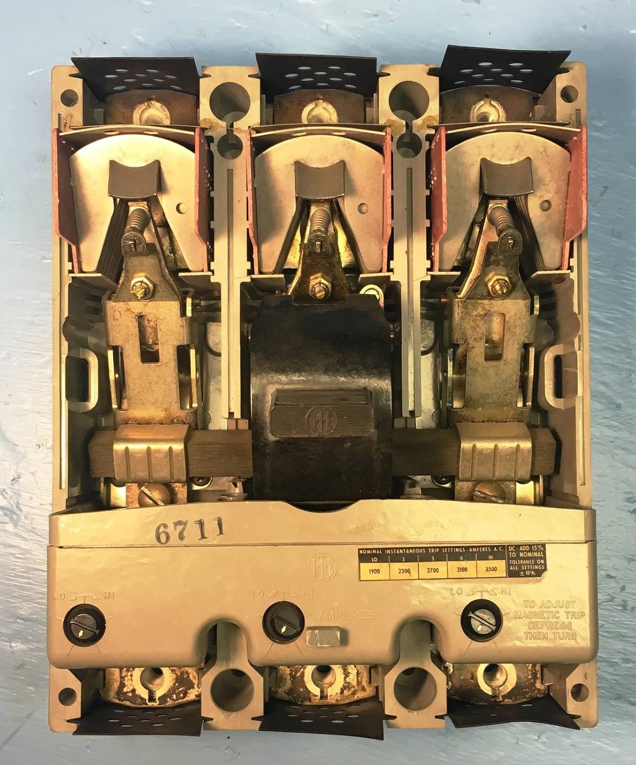

Most buildings are not coordinated. Breakers are left at their factor setting dials and thats it.
I'll also go on a limb and say that a breaker which has not opened in 20 years might take an extra cycle to fully open.
