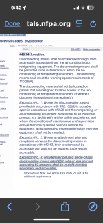

Does 440.14 in the 2023 actually say
“Disconnecting means shall meet the working space requirements of 110.26(A) regardless if equipment is likely to require examination, adjustment, servicing, or maintenance while energized or not" modifying 110.26 in legally enforceable language? Or does it just say
Disconnecting means shall meet the working space requirements of 110.26(A)?
