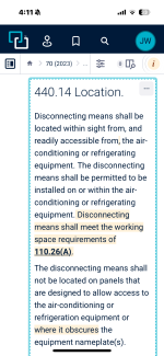

NEC 110.26(A) working space requirements to a 60A non-fused disconnect should not apply?
Does 440.14 in the 2023 actually say
“Disconnecting means shall meet the working space requirements of 110.26(A) regardless if equipment is likely to require examination, adjustment, servicing, or maintenance while energized or not" modifying 110.26 in legally enforceable language? Or does it just say
Disconnecting means shall meet the working space requirements of 110.26(A)?
No, it does not say that, and it does not modify 110.26. What it does do is reference the requirements in 110.26(A), i.e. the various dimensions and other limitations in 110.26(A)(1) through (6), and says that those apply to the specified HVAC disconnects independent of whether the first paragraph of 110.26(A) would also cause them to apply.

Would you guys think the clearances mentioned in 110.26(a) would be required if a 2 pole 30A toggle switch were located at the outside condensing unit to serve as the disconnecting means and the overcurrent protection was provided by the breaker in the panel?
Comes down to AHJ and their determination of what may be likely to require examination, adjustment, service or maintenance while energized.

In my opinion, that can NEVER be proven for any piece of electrical equipment. Remember verification of absence of voltage is examination. This will get a violation notice from me and every inspector I know, every time.
There was no intent to change anything with the addition of the 2023 language in 440.14. It does nothing more than the previous Informational Note #2 that was deleted because 110.26 is in Chapter 1 and applies through out the code. In fact the language in 440.14 in the 2023 code is a violation of the style manual as it is redundant. 110.26(A) applies no matter what.
I don't see anything that calls out any specific type of equipment, and working space is pretty much unchanged from what it has been for a long time. What I do see that has changed is it now applies to 1000 volts nominal or less and over 1000 volts is covered elsewhere. Still just mentions where the equipment is likely to require examination, adjustment, servicing or maintenance like it always has mentioned but no mention of what specific kind of equipment this may or may not apply to.
I wasn’t saying there was any change to 110.26(a) I was saying 2023 was the first time that 440.14 has specifically said the disconnecting means shall meet the working space requirements of 110.26(a)
But older codes had an Informational Note telling you to read 110.26. There was no need for the 2023 language change, as 110.26 always applies unless there is something that says it doesn't.
