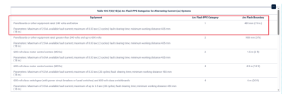

And it can't be hand-written. The cost for printer + starter supplies (ribbon and durable vinyl) is going to be ~ $3,000. I'm in Oregon, so I'll be curious to know which part of this upcoming 110.16 will be adopted/amended on the state level.
I can use NFPA 70E, Table 130.7(C)(15)(a) to determine my arc flash boundary* and PPE category**
* this satisfies item #2 in NEC 2026 110.16
** this satisfies item #3 in NEC 2026 110.16, the latter part of the "or" statement: The available incident energy or minimum required level of personal protective equipment
How are you using those tables without knowing the available short circuit current and clearing time of the upstream breaker?
For the single-phase subpanels, 120/240 volt, that we're using on our mobile/modular buildings - those tables don't require me to use the info from the upstream breaker.
NEC 2026 110.16 is asking for the arc flash boundary and the available incident energy or minimum required level of personal protective equipment.
That information can be obtained from NFPA 70E, Table 130.7(C)(15)(a)
