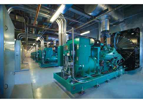

Ok, so here is my thought process. Picture a facility requiring full backup. This is becoming the norm more and more often due to hurricanes and the need for cooling during blackouts. 3000 kw worst case peak as an example (see attacked picture).
1) Four 1000kw generators or six 600kw generators feeding into parallel switch-gear, 5 to 12 ATSs. Cost is allocated into paralleling gear and a dedicated critical branch. While N-1 is afforded in that any one generator can fail or be taken out of service- several common mode failure points exist. The paralleling gear electronics, the gear's busbar and the generators being all at the same location. It looks elegant and the manufacturer like the $$$$.
2) Three 1,250kw generators (or 4 900kw) seeded at different points in the basement preferably in the building- one in the sublevel basement, one on a roof mezzanine, the other on a middle level elevation. Each with their own day tank and independent fuel supply from a flood proof tank farm. Each feeds its own ATS and in turn 3 branches with all load evenly distributed among them. Each separately distributed through out the building. The reserve 250kw in each genset is such that if one fails or its ATS, important cord and plug connected loads can be placed on the renaming branches.
OR, NICUs, ICUs and the ER will get all 3 (or 4 branches) at the headwells, booms, PBPUs and at least two for corridor/room lighting. Purple circuits run overhead through the drop ceiling coming north, Orange originating east/west direction and Brown circuits running from underneath the floor slab. Residency dorms brown for lights orange for receptacles- in alternation 6 configs. Electrical rooms, mechanical rooms, elevators rooms, ect having at least 50% of the lighting and outlets on one branch 50% on another. ATS, branch gear and genset rooms two branches 50/50 preferably not affiliated with the gear at hand. Stair wells two risers from different branches or stairwell A has a Purple riser with floor one having an Orange fixture at the landing floor in the stair well two a brown fixture off the hall lighting in the well, floor three orange ect in alternation. Elevator rooms may have manual throw over abilities provided elevators are interlocked for controlled car release during the failure of one branch.
I will give you that the above design will frequently run the generators at less then half load due to oversizing for inrush and load transfer in addition to varying HVAC loads based on time of year.
However, this systems achieves true 3x (or 4x) without any common failure points that most hospitals- even the top notch facilities- simply do not achieve while paying more in capitol costs and then maintenance costs in the long run.

The Siemens design is vastly superior. I like that they bring normal, essential, and UPS power to all important loads. I would cry with joy if America had such requirements.
The generators in different locations is a better/safer approach. In an area prone to hurricanes I wouldn't want them in a basement nor a roof. I might also like to see load shedding ability and automatic means of backup between them. But hey, I'm reasonable and know I can't have everything I want.
We could argue about the wisdom of having several sources in OR vs most sources from a common iso panel but the iso transformer being fed from those "several sources" (like the Siemens design). You certainly need some of both (mostly because a lot of equipment in an OR doesn't belong on iso power systems). In my experience you aren't going to have doctors and nurses trying multiple outlets until they discover a live one. Still, I favor your overall concepts.

I would want everything associated with my chillers, all towers/pumps/chillers/etc, to be on a totally separate generator system and POCO feeders in a detached building. This allows an "interrupt-able rate" of power from POCO, maybe even a load shed program. Cuts bottom line costs and removes the big loads from my essential generators.
I like your idea of "distributed generators" but I would want a way to tie loads together if a given generator failed. Seems like an ATS could do this without any parallel gear (maybe even a static switch?)
Time and time again I'm seeing this in hospitals- feeding everything through parallel gear:
I want to take the same and run it into individual gear/ATSs dedicated to one genset like this:
So having 6-12 separate systems.
Example to ponder- NYC 911call center and emergency management. Would you;
A: Feed all this into paralleling gear?
B: Have 6 separate emergency systems with only UPS/critical toggling between two?
(I want to see those electrically operate dampers go btw)
