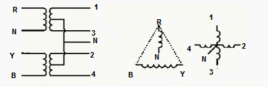

This may be the wrong place to ask as 2-phase is pretty specific but does anyone know if the neutral conductor of a 5-wire, 2-phase, system is a 'current carrying' (CC) conductor? Its pretty much two single phase systems that overlap so I say no.

Have not worked with a two phase system but why would you consider the neutral to be any different than a neutral for a split phase or three phase system? It is designed to carry all unbalanced current or and single phase loads. I would consider it as a current carrying conductor.
I think both of your responses ignore that there are cases where an NEC defined neutral is current carrying, and cases where it is not, per the section I cited above. The OP has a reasonable question.Welcome to the forum.
Any current on a genuine neutral is current not being carried by one or more lines.
It is considered to be a non-CCC.
OK, this is not phrased correctly, will reconsider.If you have a set of n+1 conductors for which the currents sum to zero, then you have only n CCCs.
Which is the reason for NEC 220.61(A) Exception. For unequal currents A and B on phases 1 and 2, the neutral current will be sqrt(A2+B2).In the drawing above, if there are equal L-N load cuurents on 1 and 2, the neutral current will be 1.414 times this current.

At my first job we had two phase five wire. We used the fifth wire that was center tapped to both phase to supply 120 volts for luminare & receptacles. Every time a two phase motor burnt out we would convert over to three phase. By the late 1970's our supply house in my stocked 30 amp two.phase four poke four fuse safety switches made by a low quality company. When a two phase started but the dust we would replace it with a three phase three poke starter and bolt on a lower pole. I got to wire in a rewound two speed two phase motor that had 8 leads. Worst thing about two.phase if you cross phased the connections instead but each motor winding receiving 240 vokts would only get maybe 170 volts.This may be the wrong place to ask as 2-phase is pretty specific but does anyone know if the neutral conductor of a 5-wire, 2-phase, system is a 'current carrying' (CC) conductor? Its pretty much two single phase systems that overlap so I say no.
Oops, should have also replied that on a two phase five wire system the nuetral is only current carrying if 120 volts loads are using power. The nuetral never gets connected to a two phase motor.Came to.my old mind that.flimsy Wasworth company were the only two phase safety switches supply house stockedAt my first job we had two phase five wire. We used the fifth wire that was center tapped to both phase to supply 120 volts for luminare & receptacles. Every time a two phase motor burnt out we would convert over to three phase. By the late 1970's our supply house in my stocked 30 amp two.phase four poke four fuse safety switches made by a low quality company. When a two phase started but the dust we would replace it with a three phase three poke starter and bolt on a lower pole. I got to wire in a rewound two speed two phase motor that had 8 leads. Worst thing about two.phase if you cross phased the connections instead but each motor winding receiving 240 vokts would only get maybe 170 volts.
