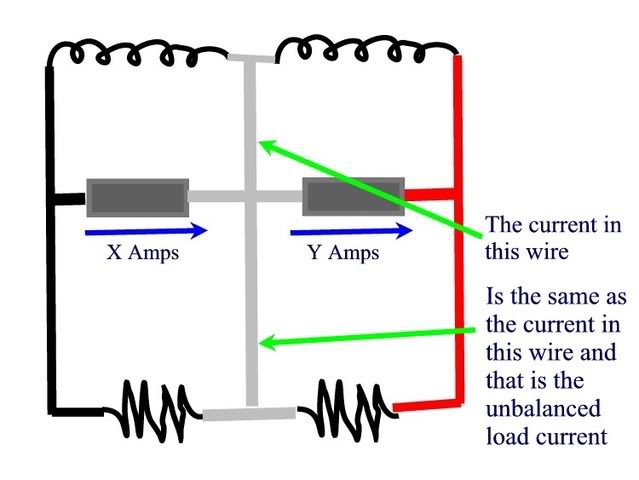

Tallgirl, you missed what I was saying. Please allow me to clarify:
I calculated about 30 various scenarios involving a 120/240 single phase service, inverters of various sizes, and various loads. I could produce no results where the service neutral was carrying anything more than the unbalanced load, even in what seemed to be worst-case scenarios.
My only assumption was that the inverter maintained equal current output on both line conductors. I think this is true of typical inverters. As long as the currents produced on each leg of the inverter are about the same amount, the inverter, in reality, does not even contribute to the unbalanced current. This may seem strange based on your original problem presented in your original post, where 5 + 5 made 10. But really what is happening is the inverter current is flowing right through the inverter from 1 leg to the other. The unbalanced load current is what is flowing on the service neutral.
The only scenario in which the neutral was overloaded was with a large current capacity output inverter, and a large difference in output current on one leg as compared to the other leg from the inverter. This scenario involved an inverter which was much larger than what is typical in a residential application with solar panels on the roof or in the backyard.
So, the answer is, at least in my mind, that a typical residential solar power system has no possibility of overloading the service neutral. Now, all this is speculation based on my knowledge of electrical theory. I haven't done any research here.
It is certainly an interesting subject, and I am surprised that none of the other "theoretical" forum members have jumped on this.
And just so we are clear, I'll say it again: An inverter with an equal output current on both output legs will contribute absolutely zero current on the service neutral.
Look at the diagram below.
It is straightforward to see that as long as the current from each leg of the inverter is substantially the same, then, by Kirchoff's current law, the only current in the service neutral is the unbalanced load. The inverter does not contribute to the neutral current, even though our intuition says that it does.
If X amps = Y amps then the only current flowing out of the junction between the inverters will be equal to the unbalanced load. The inverter current has nothing to do with it.

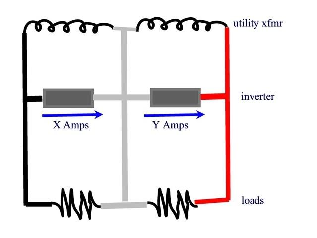

crossman said:
Here are my thoughts on current directions. This, of course, is for one half of the sine wave, for the other half, just reverse all the arrows.
The black leg from the utility is 5 amps SELL and the red wire from the utility is 5 amps BUY.
I do not understand this concept of 5 amps sell and 5 amps buy?
Wouldn't it really be that the primary of the transformer would just see a lessor demand by the amount of the load that the inverter was taking up?
We do not really have two independent sources from the utility do we?
(yes two secondary coils but only one primary)
I was having a hard time with the diagram since it shows a total load of 2400watts load and the inverter providing 2400 watts load power. This would imply a net of zero from the utility ?
I know little about dual leg inverters, do they really have to supply equal currents on both legs (if they have a neutral as shown)?
I envisioned a diagram where the load currents are as shown but the inverter supplies 5 amps on one leg, 10 amps on the other leg, 5 amps on its neutral, 10 amps on the load neutral and 5 amps on the utility supply neutral.
This way the utility supplies 600 watts of the load and the inverter supplies 1800watts. Without the inverter there would have been 10 amps on both service legs. With the inverter there is now zero on one leg and 5 on the other.
I would think the inverter legs would supply a variable current on each leg as required up to a current limit point. At that point the utility would then take over.
Of course there could be many different scenarios /current divisions/loads but The concept of buy and sell on the two different legs is confusing to me.
ELA said:
I do not understand this concept of 5 amps sell and 5 amps buy? Wouldn't it really be that the primary of the transformer would just see a lessor demand by the amount of the load that the inverter was taking up? We do not really have two independent sources from the utility do we?
With everything set up properly, you can actually sell energy back to the utility.
That is correct. We are buying 5 amps on one leg but selling 5 amps on the other, net result is zero. The meter would not be turning.
ELA said:
I know little about dual leg inverters, do they really have to supply equal currents on both legs?
As far as I know, they produce the maximum current which is provided by the amount of sun at any given time on both legs.
If it is a bright sunny day, and no one is home, and 95% of the load is turned off, why not go ahead and let the inverter produce maximum amps on both legs and sell the energy back to the utility? In effect, the meter turns backwards.
