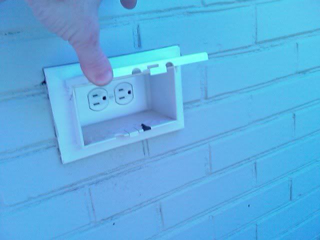

Here are the pics I talked about. I was able to stop by today and snap one or two, but it saved it as a large bitmap file so I only loaded one. We did this house some months back and had the masons install these for us. (Actually, they forgot and had to go back and cut them in. :roll: )
