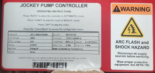

The engineer adjusted the print to run the conduits above ground. Now the wires will be fused before entering the building. The print (see attached) shows:
1- 400A disconnect fire pump (no fuse size shown)
1- 30A disconnect jockey pump (no fuse size shown)
4- #1 copper wires feeding the disconnects
My questions are ...
#1) Is what size fuses would we use in each disconnect? If I look at article 695.5 (B) the primary over-current protection device shall carry indefinitely the LRC for the fire pump. The fire pump that will be installed shows a LRC on the pump controller of 468A. If I'm understanding this correctly I would need a fuse sized 500A on #1 copper wire but they show a 400A disconnect?
#2) what size fuses for the 30A disconnect.
I'm learning every day and I'm so thankful for all the help this community offers.

Yeah, it would need to be a 600 amp disconnect fused at least 500 amps, but the wire will not have to be for 500 amps. The jockey pump would be fused as normal for that size of motor.
Yes.
Breakers are also allowed. It is only the Long Time portion of the breaker curve that needs to carry the LRA indefinitely. If there is a short circuit there is no guarantee the fire pump will run at all.
