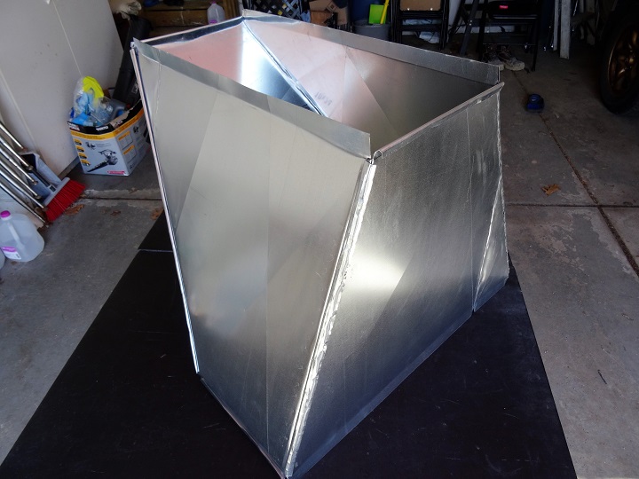

Perhaps the HVAC guy could be consulted whether the open area to the left of the conduits is sufficient by itself for a duct transition to be fabricated so that the duct passes through just on the left side of the conduits.
Or if more cross-sectional area is needed, maybe the opening in the wall could be extended downward somewhat, and a horizontal to vertical transition similar to the following one could be fabricated to put on both sides of the opening:
http://www.ductworkinstallation.com/Portals/0/Guide 102/443tfv.jpg
It would reduce the headroom, particularly closer to the wall. But if it goes no lower than the top of a door opening that might be OK.

Have HVAC enlarge hole and use a split duct.
They could also use a rectangle duct with a long dimension going up and down.
