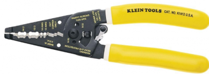

That being said, these kline strippers are a life saver with this new hard jacket. I measure the wire to the box, clip it with the end, then stick it in the box and yank the jacket right off.
The end will only cut the jacket on 12/2 and 14/2. It's very handy.Screenshot_20221025-182103~2.png
With the thicker sheath I was worried about knicking the conductors inside using the NM strippers.
I've tested it, cut the jacket 5 times or so and slid the pieces off. The insulation was not damaged.
I figure it's no more risky than trying to cut it with a blade. Been doing it for a couple of weeks now and I endorse it.
Just cut it at a perpendicular angle.

I've been using the southwire nm stripper without nicking the conductors on that new southwire. Maybe the intent of making the sheathing tougher, sell more strippers? It works nice on the UF cable, that was always a pib to strip.
Still not sure I like the tougher sheath though. If the same compound will be used on the 14/3 or 12/3 will have to buy their 3 wire stripper too. Master plan?
