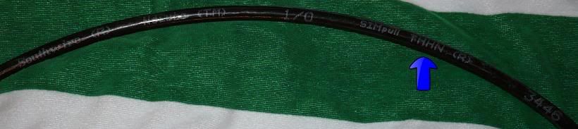

Funny you bring this up, because this just caused a little heartache here today. The inspector was looking at the new underground pull, and in his kind-hearted way, he said, "I need to see something with a 'W' in it on those conductors". I always took for granted that all modern THHN was also THWN. Not so. GRRRRRR!!!!!! What a way to get caught with your pants down. I'm ticked.
Okay, now that I read the manufacturer's data, the actual name of the product is "SimPull THHN". They actually put THHN in the name of the product, but it is really also dual rated. Why don't they just put that on the freaking imprinting on the conductor? This really jammed things up today.

That will really be up to the inspector, if the jacket does not have the 'W' on it he can turn it down.
Look at 310.11(A)(2) for the required markings.
If it doesn't have a W on the conductor you can't use it in wet locations. I don't care what the catalog or ad says.
Don
Don
In spite of 110.3 ?
So does this stuff have anything more that "Southwire No lube Simpulll XX AWG THHN" printed on it? If so, that would be much less information than they usually print.
