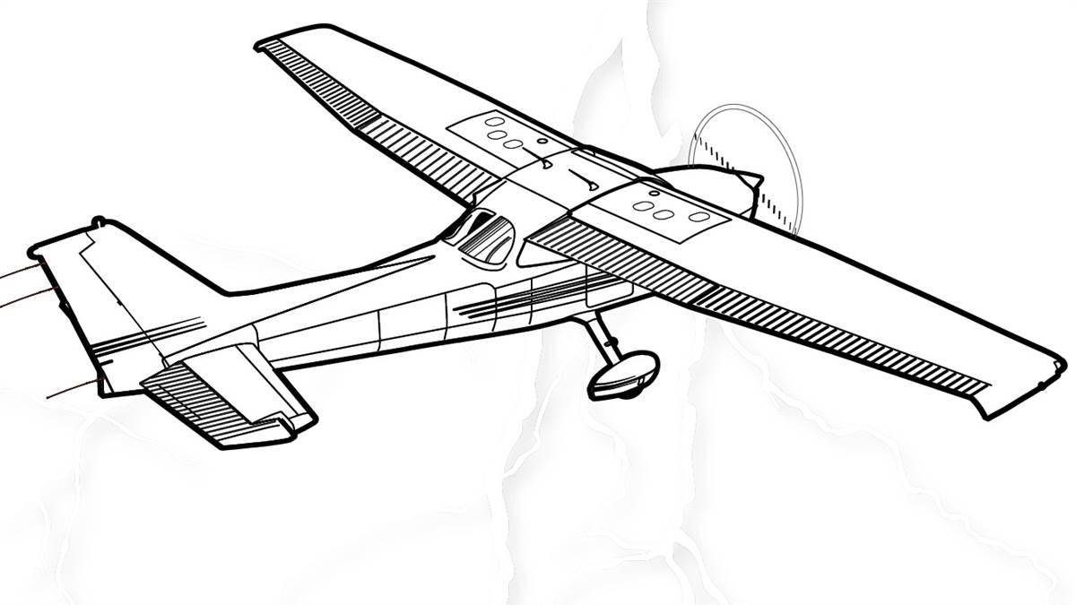

Airplanes, too. When there are thunderstorms nearby, draining any static charge off the airframe gradually will prevent it from being discharged violently.
fb_img_1439006924672-jpg.14302
