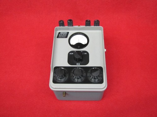

Null Balance Tester?
Mississippi
First thing sorry for the bad picture quality. Second wth is this? I’ve installed plenty of ground grids but I’m struggling with this one. Context this is a football stadium, track and field with aluminum stands.
It is a requirement to measure the earth resistance of the installed ground grids using a "3 point tester" also known as "fall of potential" test.
The "injector probe" of the tester should be away from the grid being tested a distance equal to 8 to 10 times the diagonal measurement of the grid.
