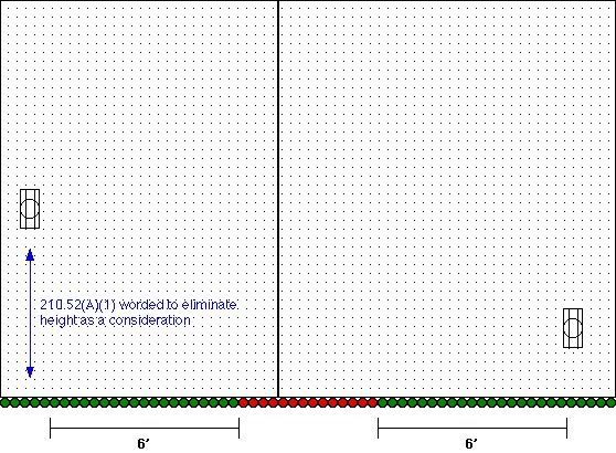

It's not worded that receptacles shall be placed on every wall. It's worded backwards, with an unexpected result.
(1) Spacing. Receptacles shall be installed so that no point measured horizontally along the floor line in any wall space is more than 1.8 m (6 ft) from a receptacle outlet.
There are two key components of this section:
1.
Think of it as X and Y coordinates, like a map or like a graph. Where X meets Y, there shall be an outlet within 6'.
So, where the floor area meets the wall area is where the official measurement is taken. Personally, I don't like to bend over, so I take my measurement at waist level, trying to keep the tape level while I measure. This is not scientific, and on occasion I goof.
2.
Technically, what this says that where these two planes intersect, there shall be no point that does not have a receptacle within six feet of it.
So look at this wall:
The green dots are points along this intersection that are in compliance with this rule. The red dots are points that are in violation of the rule.
(A)(1) establishes that you do not leave the floor line to take the measurement: "Measured horizontally" means we can't include the point or two (that are red, immediately next to the green ones) that would be added by lifting the measure off the ground to the receptacle.
Imagine placing a thumbtack with a 6' string on it at a red point, stretching it tight, and laying it on the floor. The string is outside of 6' from the point on the floor where the receptacle is. If you were to lift this string, you could touch the receptacle; it would be within six feet. But this section declares that we measure horizontally, not diagonally.
Essentially, all the receptacles, and all the points they are to serve, are considered at floor level for judging compliance with this section.
A basic rule is that on any line, there are an infinute number of points. So to get on your knees and measure from every point to verify that ever point on a wall is in compliance, is a very backwards way of thinking. This is why this concept is kinda odd for us to try to grab onto and use in the field, because it truly is backwards. It seems that the points are in violation, not the receptacles. When we walk into a house, all the points are in violation until we are done laying out.
So we have developed a way to cope with this rule, by creating one of our own: There shall be a receptacle within 6' of every doorway, and there shall be no more than 12' between receptacles. This is an active, practicable rule for us to use when laying out a house, because the real rule is not productive. It's a checker, not a how-to'er.
Our rule of thumb helps us to lay out a house, the real rule is the one that we have to use to confirm that we are legal, and that all wall spaces are served.
So, we're inclined to believe (thanks to experience and our little rule of thumb) to believe that a receptacle has to be on the same wall to serve it.
But the code doesn't say that.
Well then, it should have to be within 18" to serve a point on wall space.
Only if it's a floor outlet.
In conclusion, I can't say with conviction that this is the intent of the section, but I can say that this is my most thorough interpretation on what the text says.

Edit to add: 210.52(A)(2) is defining wall spaces, not declaring where the receptacles go. It's adding definitions so you can apply (A)(1).

How's this: 210.52(A)(1)'s receptacle requirement is related to 210.52(A)(2)'s wall space definition
as
310.15(B)'s derating is to Table 9's conduit fill.
Wall spaces and required receptacles are related, but not the same thing. When you say "the measurement starts over when you get to a door" it is true. But that measurement is for one purpose: to determine if something is a "wall space."
You don't look at table 310.15(B)(2)(a) to see if you're overfilling a conduit.
You shouldn't look at 210.52(A)(1) in a similar fashion.
George, I think that you are right. As long as your measurement is measured horizontall along the floor line.
I'd never have thought of it but I believe that you are saying that there is no requirement for the wall space to have a receptacle. Just that it be served by one. In your case it's served by one nearby. I doubt if that was the intent, but I'd agree with your interpretation.
