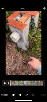

I have to run about 250 feet cause this crappy Manufactured park had this feeder go straight through two other property and a phase was lost and I am not going to fix the wire anyway since its only 2/0 aluminum on a 200 amp breaker.
Either way. What do you think the most complaint way to set a new meter with main breaker. meeting Power company tomorrow.
Was thinking of seeing of there cool if I run a stub up to the center cavity were there feeders are coming in.
I don't want to reuse this box cause its only 16" from grade and rusted through the bottom. It's really up to power company how they want me to address this.
This park is really sketchy some of the Mains are just direct buried wire only 12" deep. I hit a water main once that was 6" lol.
