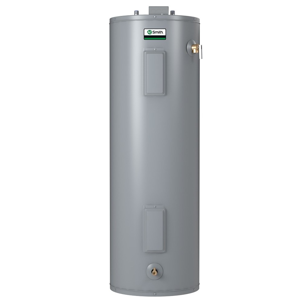

Each of those heaters is 36kw at 240 volt (150 amp) or 26.6 at 208 volt. Tell them you need to use tank type water heaters. 1 30Amp two pole/apartment.
A-men, it baffles me that people use those things. Elec tanks have very low losses because the whole unit is encased in foam (unlike gas tank units), low capital cost, low installation cost, unlikely to have problems or require maintenance. If people are concerned about running out of hot water, get one of these that that have bigger tanks and/or can be configured for 12kw.

If you are looking for efficiency overall, the heat pump tank water heater is the best bet. Comparable cost to tankless but no where near the power requirements, and 2 less breakers and overall amperage requirement. I would never recommend electric on demand anywhere north of Florida, the temperature lift required way to large for the typical 40-50 degree water coming into the WH forcing a way higher electrical load to get a usable hot water. Gas on demand a whole different thing (but you indicate not doable).
The problem with these is the amount of cold air they generate. These too would be good in a hot climate and if put in the garage would help keep it cool whereas garages aren't normally conditioned spaces. But in an interior room in a heating climate, these don't seem like a good idea either unless they have heat pump water heaters that duct the cold air outside.
