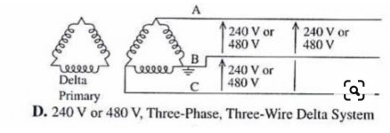

Open wye - Open Delta arrangement, with one phase (call it A) coming from one Sgl ph transformer secondary, one phase (Call it B) coming from the other sgl ph transformer, and one phase (call it C) coming from the bare neutral conductor. The third transformer on the pole is a 240V single phase transformer that feeds a separate 240V/120V service for their office and lighting circuits, through a separate meter.
Just asking here. You sure about this? That third phase coming from bare neutral sounds like corner grounded delta.BD2FD9B0-D996-4837-9763-E9BFF835CC2D.jpeg

Just asking here. You sure about this? That third phase coming from bare neutral sounds like corner grounded delta.View attachment 2558981
Yes, I agree, but it is corner grounded OPEN delta, with one winding missing, as there are only two single phase transformers involved. I believe the primary is Open Y, with MGN. In your attached diagram, if you remove the left winding, between A and C, that is what this system looks like.
That bank is for LIGHT three phase loads, and I’m not sure why they have a third transformer feeding the single phase portion. They really need to add the third transformer and close the delta if the machine loads are heavy.
Even better would be to build the bank using all three transformers the way it’s supposed to be built.

In addition to the excessive voltage excursions mentioned, it's possible that the higher line-to-ground voltages on the ungrounded phases of the corner-grounded delta could be a factor that 's contributing to the equipment damage.
