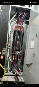

Why would someone need 2 feeders in one panel ? I understand the load side supply power downstream but why the double lugs on the line sideIt's a feed-through panel, probably between floors. The incoming and outgoing feeders land on the double lugs that were installed to accommodate the paralleled feeders.
The 3-pole breaker is merely another breaker, possibly supplying another panel or a transformer.
Those are parallel conductors.Why would someone need 2 feeders in one panel ? I understand the load side supply power downstream but why the double lugs on the line side
Now I'm questioning the diagram from what I see a 3 pole breaker is feeding the second the panel but now why does the second panel have 2 black 2 red 2 blue going into the main breakerTo add, those pairs of conduits do not branch out in different directions.
You basically have what is pictured here:
Because they're effectively the same thing as double lugs, whether on a breaker or panel terminals.Now I'm questioning the diagram from what I see a 3 pole breaker is feeding the second the panel but now why does the second panel have 2 black 2 red 2 blue going into the main breaker
