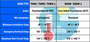

If your worried about insulation resistance holding up in waterlogged PVC use something besides skinny THWN-2, I would specify XHHW to your transformer, you could also use single conductor UF. The GFCI is not going to see past the transformer so I would not be worried about trips.
Over 10 years ago I did a design for a large public outdoor public art garden where you could have a occupant load of over 100 , the path lighting was all 120V and on GFCI breakers from a panelboard, the wire was #10 XHHW copper, the XHHW was chosen to because the insulation holds up better.
OK, the four horsemen of the apocalypse are cresting the hill so I’ve finalized the design and am ordering parts. XHHW would have been better and we’ve used it on high voltage parts of this project but the contractor supplied THHN so I’m stuck. It should be OK. For starters, reading through everyone’s comments has inspired me to take a creative approach that takes care of the silly fountain in the middle of things with its two submerged puck lights. We have a Jandy Aqualink RS8 control center in the pool room with extra relays because I over-specced the pool guy’s choice. I’m adding a GFCI breaker and feeding two of the relays whose outputs leave the pump room to the main wiring area. One relay jumps on the high voltage highway to the courtyard and on to the pump. The other feeds an Intermatic PX50S transformer listed for submersible fixtures and its output jumps on the low voltage highway to the puck lights. These relays are conveniently controlled by the pool keypad in the living room. The “critical path” lights are fed by an Intermatic PX300S controlled by photocell and hardwired to a 15amp breaker. To control the other six strings, we are using three “app based” Haven Lighting Stratus transformers having two zones each. Haven can combine the transformers and show all six zones on a page for the client. FX, Kichler and other app based transformers I looked at could combine the transformers but only showed them on screen so you have to choose a transformer to see the zones-too confusing for my client. These can be connected to a GFCI circuit. And, if the GFCI ever nuisance trips let’s just say the replacement won’t have that problem.
