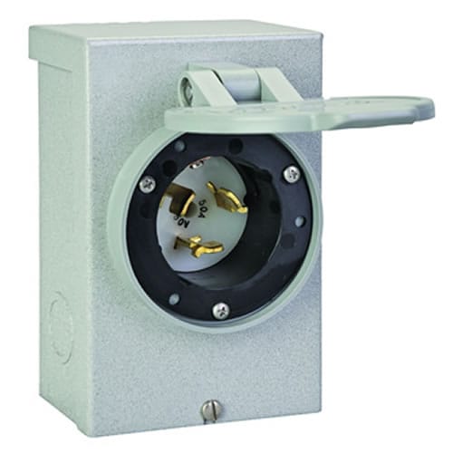

Has anyone ever installed a PB50? (50 amp rated exterior power inlet)
It is a huge PITA to get a #6 AWG into these things. I know they aren't used very often since most people with manual generator setups have a smaller generator, 30 amp is pretty common around here (NH)
The manufacturer (reliance, I think) uses the same tiny enclosure for the
20 amp, 30 amp, and 50 amp inlets. You pretty much need your sledge hammer to put the cover on a pb50. You know what I mean if you've done one. I've used a 6x6x4 steel W.P. JB and put a 2.5" hole in the cover to accept the 50 amp inlet. I'm sure there's some violation in doing this, but it's so much more user friendly. What have you done for customers larger portable generators?

I installed one on my own house just yesterday. It's a tight fit allright:roll:
It's a four wire receptacle, you can just see the fourth teminal at the top

while it looks like a 3 wire connector, that is a 125/250v CS style 50a 3P4W twistlock. The 3 pins are H-H-N, and a portion of the exterior of the female contacts a metal strip on the inside of the male for the ground connection.

those reliance things are junk. They housing is way too small for a 50amp twistlock, i have no idea how that thing has UL (or does it?)
For 50a inlet, I recommend the midwest electric U50N. Much larger housing, plus the inlet is at a downward facing angle and the cover closes with the cord plugged into it.
