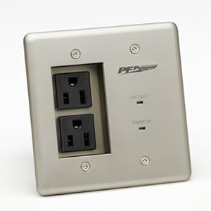

My supplier has a surge suppressor receptacle that is recessed like a display receptacle. I will have to get the brand. Here is one but it not the one I was familiar with
Here is one similar to the one City Electric sells. It is neat the way the receptacle is turned at an angle. The receptacle is a surge suppressor type also.(not pictured)
