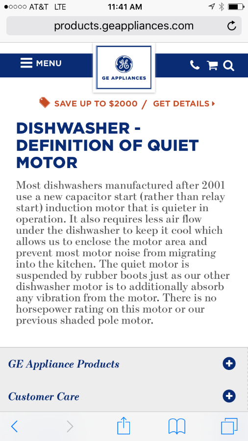

When GE ditched the motor:
GE is blowing smoke to those that don't understand, both motors are likely controlled by a "relay" of some sort. They likely switched from a shaded pole to a PSC motor, and it probably does run cooler under same load conditions.
They are blowing and that explanation sucks to be honest. That and the replacement does not come with the boots they brag about. But they are still correct about the shaded pole motor being used up until 2001. The new motor is indeed cooler and a heck of a lot quieter, not to mention current draw went down by about 4 amps.
