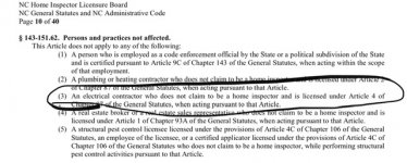

I'm a licensed electrical contractor in North Carolina. I'm not a licensed home inspector. My understanding is that the home inspector advised the homeowner to have an electrician (me) assess their system.

As a licensed electrician you should be able to provide a home electrical inspection. You should always limit the scope of an inspection by stating what you will inspect and what will not be covered.
