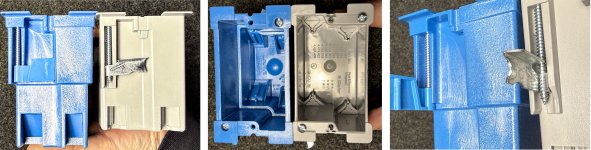

The plastic toggle ears on a blue Carlon PVC old work / remodel box broke. Both. Never happened before, I don’t over tighten. Both just cracked around where the sheet metal screw threads through ears to draw the plastic tab to the wall. This occurred after being set in place a week. Plug, with box attached, pulled right out of wall on client.
My trust is completely gone for these boxes.
In the past I have seen grey PVC remodel boxes with ‘metal’ ears / toggles that the sheet metal screw threads through (now I understand why). Searched everywhere online but don’t remember brand nor can I find any reference to them even though I have seen them occasionally within the past two years. Did I hallucinate?

Possibly a defective run of product.
I have never had an issue with Carlon . Use both round and rectangular boxes daily.
One thing I always do before installing is to run the screw once through the tab just to ensure it doesn’t bind up in the “slide” once it’s in the wall or ceiling.
Friends don't let friends buy Carlon boxes. Mostly junk that I would not use even if it was free.

I don't like most of the blue Carlons. I've seen that too, with the toggle breaking off. Also seen the 6-32 threads get brittle and break out when replacing a switch or receptacle. A major pain to fix, sometimes have to replace box. Had to do this in my own house. Fortunately was when I was already having patching & painting done. I cut out the wall enough to put in a gray nail up box.

We just had to replace a Carlon light box that started to crumble like a cracker. The light fixture fell out of the ceiling when the owner was changing a bulb. I chocked it up to a bad batch at the factory.
Other than one off issues I haven't really had ongoing complaints. I typically opt for the SuperBlue versions (BH234R, BH118R). Whenever possible I use a stud mounted box for receptacles since they see more abuse. I'm less concerned about switch boxes and don't mind if they're drywall mounted.

Years ago I had an inspector tell me that these are not even listed for fixture support in a ceiling, they can be only used as outlets for smoke detectors and the like, and if I recall correctly they can be used in a wall to support a luminaire of up to somthing like 5 pounds, I have not looked recently to verify that is still the case perhaps with modern plastic that changed.

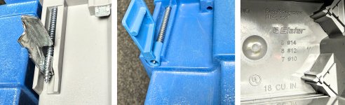

Picked up an open case of S118W (18cu in) yesterday and ordered some S122W (22cu in) as well. They come S116W / S118W / S122W.
Looks like inserting NM cable will be more difficult, but I can't ever have this happen again - clients just won't understand.
I agree it could have been a production error, however once bitten.
Not yet sold on the 6/32 metal clip for quick push insert (if that's what it's for) (didn't push in easy for me = good) but it held well when I cranked a device screw tight to test.
Comparison below to Carlon BH118R (18cu in) vs Pass&Seymour Legrand / Slater S118W (18cu in)
