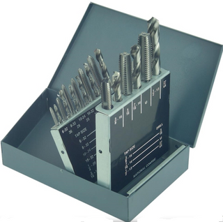

If you are going to buy a tap set for this type of work, I strongly recommend getting a set with two flute tapes instead of the traditional 4 flute ones.
The work much better, especially if you are using them in a drill motor.
This drill tap set from Greenlee works great, its fast and easy to use.
Use with tapping oil, the 6/32 are (as you might expect) easy to break.
I had a working set and an a second case with 2 of each tap. Greenlee sells the taps individually
I have tapped hundreds of holes (not with the same tap!) with them.
