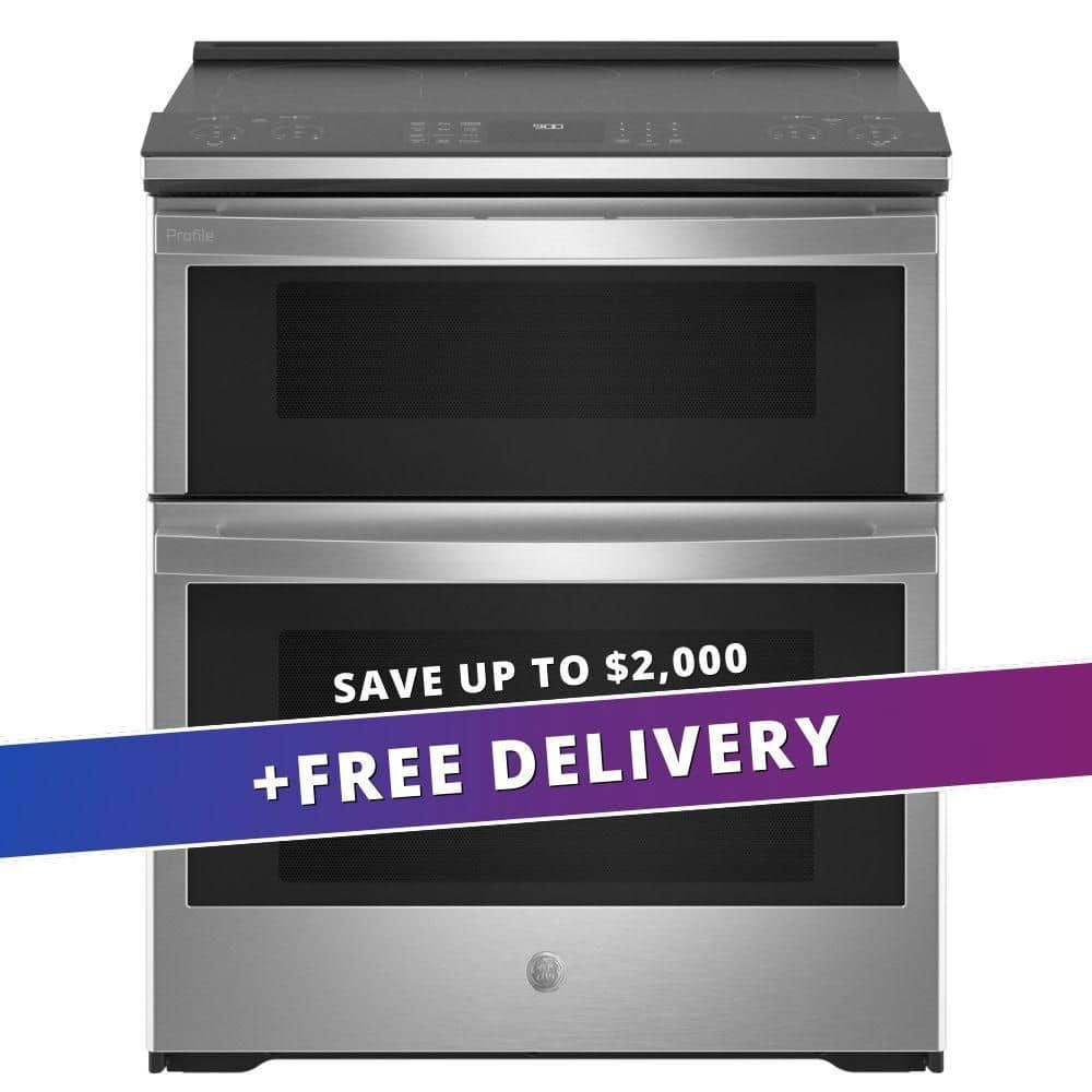

Say I have a 16 kw range - cooktop with a double oven- one piece. The nec states 40 amps would be compliant but obviously you may want to go higher. If this range were not in a residence I would have to use the nameplate which if the voltage were 240v the amps would be 67 amps.
Now can I run a #4 copper -no nm cable- at 75C and use a 80 amp breaker on this range?
For that matter can I install a #1 conductor @75c and use a 125 amp breaker.
I think you see where I am going. I know some of this is ridiculous but if the manufacturer doesn't state maximum breaker then it seems compliant, not practical. I am just wondering if there was something in the NEC that I am missing that would limit the overcurrent protective device.

If they (mfg) don't list a breaker size, I just go off the kw rating of the stove. I think the NEC is only concerned that the breaker match the conductor size. Also, any specs listed by the mfg, such as max OCPD.

I really wish that the manufacturers of appliances like this were required to put a required OCPD rating on the nameplate. The NEC has said to use 40A forever which has become the standard. If it's the "standard" then stop making 16kw ranges. Seen any dryers that require more than 30A? I don't know why there is so much confusion.
That said, I normally provide a 50A circuit and receptacle. Range cord is 50A anyway. There is no 40A receptacle and range cord. More than 50A what do you do? Hard wire?

Dennis, where are you getting the 125 amps from?
If this is a household type range the maximum overcurrent protection would be 50 amps. 422.11(B)
If this is a commercial type range the maximum overcurrent protection would be 60 amps. 411-11(F)1
If this commercial type range that meets 422.11(F)(2) you can have larger overcurrent protection but this type of unit would never be install as a household range.

Curt the 125 was a point I was making that there didn't seem to be a limit however I knew there had to be a limit. I don't think (b) relates to this because it says if the demand is more than 60 based on table. The table demand is 40 amps.
(B) Household-Type Appliances with Surface Heating
Elements. Household-type appliances with surface heating
elements having a maximum demand of more than 60 amperes
calculated in accordance with Table 220.55
shall have their
power supply subdivided into two or more circuits, each of
which shall be provided with overcurrent protection rated at
not over 50 amperes.
The thing is this guy turned everything on and the breaker tripped in a few minutes. He swears he will be using it like that come the holidays. The electrician used #4 nm and installed it on an 80 amp breaker which is wrong in many ways. He wanted to use 60 amps and I thought that would be okay

It is my opinion that the rule in 422.11(E)(3) applies to the maximum OCPD for an appliance that does not have an maximum OCPD set by the manufacturer.
As far as 422.11(B), are there large ranges that are designed for use with more than one circuit?

Yes the unit states 40 amp but does not state that is the maximum... That is my point. If the unit is 16 kw and was on a commercial setting then we could put this on a 70 amp overcurrent protective device.
So you are saying I can go 150% of the units nameplate
I have never seen a range that can be fed with 2 circuits... perhaps commercially
Not exceed 150 percent of the appliance rated current if
the overcurrent protection rating is not marked and the
appliance is rated over 13.3 amperes. Where 150 percent
of the appliance rating does not correspond to a standard
overcurrent device ampere rating, the next higher standard
rating shall be permitted.

I could see an inspector saying “It calls for a 40A breaker. That’s what you have to use.”
roger
Fl
Retired Electrician
I also can see that tripping at times....
That would be the customer and GE's problem.
Did anyone notice the "Check local codes for required breaker size" comment?
Puts it on the customer to figure out if they made a bad purchase or not.

A range has one connection point and it is usually fed with a 50 or 60 amp branch circuit. If the range is 16kw and all elements and ovens are at full tilt they will be pulling 65+ amps.
Imo, this would probably never happen however this particular homeowner wants the worst case scenario. He actually posted here and got his thread closed because it was a homeowner.
