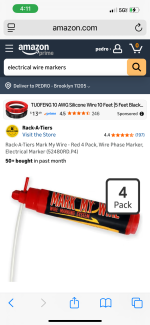

How is re identifying conductors with those markers that re identify conductors code compliant when it covers all the conductor info?
That looks like it's for small conductors that are inside of a cable. Often those conductors have no markings as the sheath has the required information so using the marker won't violate anything. For larger conductors re-identified with tape utilizing a candy cane stripe should not obscure all of the markings.
I think they make them for larger conductors
You don't need to reidentify the entire exposed length of conductor. Stop marking where the data is.
Yup, one circle of tape around the conductor is all that's required. I've seen guys use 1/2 a roll of tape to make it look pretty.
