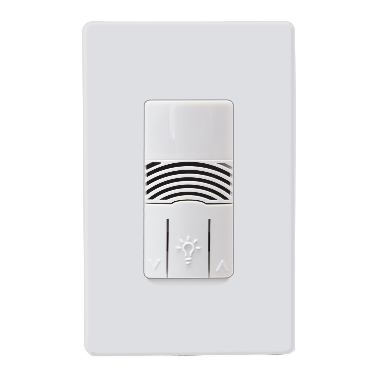

For room controls, you have two options; in-wall sensor/dimmer, or in-ceiling sensors w/ in-wall dimmer. For very small office space, like 50 sq/ft and less, I’ll typically use in-wall sensor dimmer. They are 120v powered w/ 0-10v dimming, and have built-in daylight harvesting, so they’ll adjust the brightness level based on how much natural light is in the room. See here:
