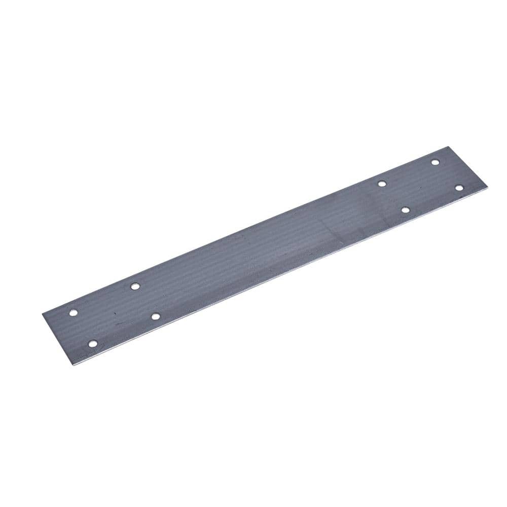

I went looking for the thickness required for a nail plate that needs to be put up where some MC cable goes around a column in my basement (can't find one wide enough - most are framing member width), and stumbled across something saying redheads aren't needed with MC cable. Found this nice bulletin.

I went looking for the thickness required for a nail plate that needs to be put up where some MC cable goes around a column in my basement (can't find one wide enough - most are framing member width) . . .
Look in the plumbing section:
