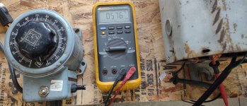

I wonder how much current the capacitors draw while reforming. The DC bus in those is about 600 volts?
For 480 volt three phase input the DC Buss equals 480 × 1.41 = 676.8 Volts DC. Usually around 665 volts. Have to be carefull whole troubleshooting larger drives. Some take over 15 minutes for capacitor bank to discharge. I measured the current for a 10 HP drive with no load. You get a spike in current for guessing a cycle or two until capacitor is charged. Did not pull any current that I could pick up with my Amprobe but should have used a VOM to get an accurate reading.
