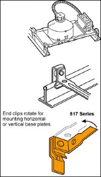

Using Halo or Juno new work cans. Temporarily place the can on the grid to determine hole location. Cut ceiling tile to fit grid w/hole. Remove the temporary can. Install Ceiling tile. Re install can & attach support wires from adjacent ceiling tiles. If you are going to screw the can to the grid do so from adjacent ceiling tiles.
how do you put in a remodel can with no tile? Either way you need the skills of cutting a hole in the tile.
What I meant was if it's a decent tile cut a hole and pop the can in, just like sheet rock. It can be pretty difficult to screw it to the grid from an adjacent tile as John 120/240 said if it's a tight ceiling. One time I drilled holes in the grid and secured it with tie wire, worked pretty good.
Again I recommend purchasing AG bars from Caddy or B-Line.
They are made for this, they clip onto the grid firmly no drilling required.
http://www.erico.com/products/CADDYcfcSusBar4LghtFix.asp
They have models to fit the different can makers and are stock items in good supply houses.
IIRC... the HALO cans' clips snapped right onto the grid (after removing the factory installed mounting nails).
Most "new work" cans I have ever seen have provisions for fastening to suspended ceiling grid. Just how secure they fasten to the grid is kind of questionable on some of them though, but same can be said for the bend out hooks on many troffer fixtures.
That's why I have the "broom stick" test. If I can push the fixture up then the clips aren't doing their job and you need some screws.
