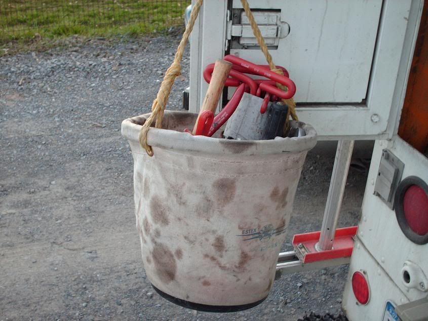

Do you keep all of you tools on the truck? Sounds like you have alot of things that are needed however maybe only needs once a year...I would like to see how everything is organized in not only your truck but others who have alot of stuff. Do you have any pics ?
1800 watt inverter runs lights, fan, portaband and other goodies.

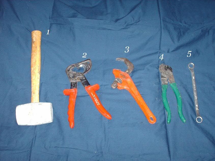

#3 in the picture below is another real handy item for turning up the nut on weatherproof SE cable connectors without leaving wrench marks. It's a Ridgid E-110:
