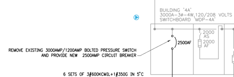

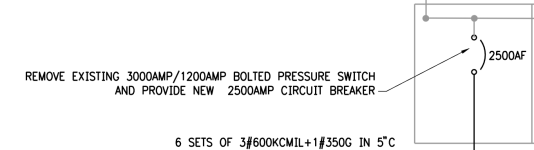

We discussed that with schneider electric and they provide us with the actual submittal, the existing drawings didn’t show the correct size. The main bus is rated for 3000A but the switch section is only rated for 1200Amp. That is why we need to change the section.I wonder why? With most breakers of that size you would be able to set the long time trip at 2500 amps.
