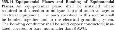

NEC requires equipotential bonding at art 680 applications. That eliminates touch potential even though the entire pool is sitting there at whatever the NEV voltage is at the service equipment. Outside of an ungrounded conductor being a problem at a pool most so called minor shock incidents are likely due to a hole in the equipotential bonding.

All the comments that indicate NEV as issue is correct and that the pool bonding system does work in it's application to make the NEV a negligible issue but that as mention will not really work in a natural body of water and dock situation, thus why the NEC requirement for signage around a dock and out from the dock to say that swimming is prohibited and dangerous in the vicinity of the dock.
One unique issue that does arrive from swimming in and around a dock that has power is if there is voltage gradient around the dock as a person approaches they begin to feel the shock and the tendency is to swim toward the dock to get out of the water but that is likely the source and as they get closer the higher the voltage present and the more they get shocked. If this is high enough it will result in paralysis and shock drowning. This too is reason for not just signage but a readily accessible disconnect. But if the source is from another nearby dock or building your individual disconnect won't do anything thus the "NO SWIMMING" warning sign required in 555.

Required signage is just a band aid, NEC needs to come up with more effective solution to eliminate the voltage potential, like requiring systems that are isolated from the utility supply or even maybe something like Ronk blockers? People have a tendency to ignore signs, even if you spell out the hazard in pretty simple to understand wording. There still is a risk if someone isn't intentionally in the water yet falls in for whatever reason as well.
