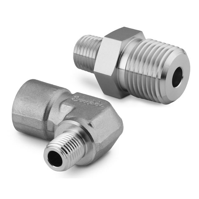

Thanks for sharing that straight (parallel) thread couplings wont seal with NPT conduit nipples.
Here's more info on other combinations:
Straight-thread joints seal better than tapered-thread joints
TAPERED VERSUS PARALLEL THREADS
Tapered Pipe Threads
..Tapered pipe threads work by interference fit and will require a sealant to make a leak tight seal. A good sealant is always required
Parallel Pipe Threads ..A gasket (all metal or composite) or O-ring is normally used to seal parallel pipe thread connections. No Teflon tape or sealant is utilized on these threads.
