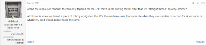

344.28 calls for 3/4" per foot of taper on RMC
No straight threads.

Ridgid designates their dies as "NPSM"=National pipe straight mechanical or "NPT"=National Pipe Taper
I was always told electrical dies cut straight and pipe dies were tapered. But as others posted above apparently that is not true according to 344.28. I always used pipe dies anyhow because that is what I had.

When I started in the business in the 80's we used the straight dies. We were taught on the job and in apprentice school that we used "electrician" dies. To this day some people still think that "plumber" dies are not for electrical conduit.

Right. Not sure but would you first run a NPT die first the run a straight thread on up to a shouldered edge? The pitch is the same for both NPT and NPS.
The dies for NPS threads have an initial "chamfer" region which ramps down the diameter when it is cutting the threads, after which it cuts the threads at a constant diameter. The end of the die also has a short chamfer to avoid making a shouldered edge.
If you initially ran an NPT die to its full extent, then the first half or so of the threads would have a smaller diameter than would NPS threads. You can make straight threads by running an NPT die further down the conduit, but they would have a reduced diameter compared to NPS threads.

So the Rigid I've gotten usually come with one end a threaded coupling installed but not necessarily tightened, but it is usually at full length of rigid threads. It is definitely different than the plumbing coupling. Is the rigid coupling a nps or npt cut?

Electrical couplings have straight threads.

Just wondering if it would be safer if taper threads were on heavy wall couplings in explosion proof areas. A lot of sparkies do not know that you are not suppose to thread in a straight thread chase nipple into a heavy wall coupling. Have done it and always tightened them up and never came loose.
