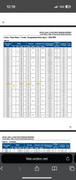

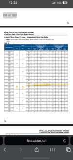

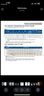

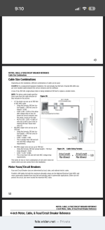

I was told well motor is 3 phase, and they will be adding a phase converter. I will need to supply wire rated at 1.25% of the well motor. 2 hp 3 phase 230 volt motor should pull 6.8amps
6.8amps x 1.25 = 8.5amps. After looking at Franklin aims Manuel. I thought I could run 2pole 20a ocod with #12 copper conductors down to the well pressure switch/ phase converter. Ocpd to pressure switch is less than 25 ft, and the well is 200ft down. I’m assuming we’ll company will run #10 or larger down to well motor and pump.
I used the aims Manuel to come up with this for voltage drop.
#12 copper is good for 510 feet according to there chart
#10 copper is good at 810 ft
25ft/510=0.588 in .0438 branch circuit distance
220ft/810ft =0.2716 well leads
If you add these numbers together and multiply by 100 you get 31% so I would still have another 69% to go before I’m over the 5% voltage drop….

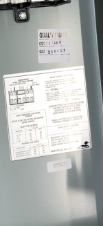

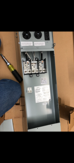

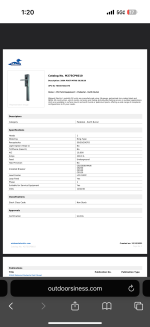

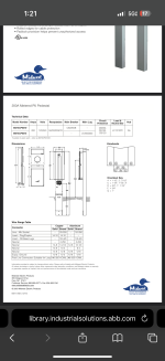

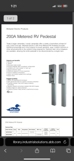

Do my tv pedestals need to be rated 200 amp to feed through 4-6 pedestals. This is the model I’m thinking of telling the rv site owner he needs to get. M675CP6010 I will provide de cut sheet in the pictures. RV pedestals will not have main breaker

Or possibly this model depending on what we can find and cost difference

Don't know much about the RV stuff, but your well pump calc doesn't seem right. If this is a single phase service, the phase converter is going to have to make up for that by drawing more amps on the single phase side in order to generate your ~7 amps 3 phase. Not sure what factor should be used with efficiency and power factor considerations, but I could see the phase converter pulling 14A or so. Then your 125% and now recalc your voltage drops.
I Haven’t done an rv site nor a well like this, but that’s what I was confused on too. As far as I know seer ode should be 240/120 single phase… The well guy said it’s a Vfd, but I think he meant phase converter because then he said it would be 2 hp 3 phase motor…
Her is how the well calculation is listed in the aim manual .
A single phase 2 hp motor at 240 will pull 22 amps according to 250.245
12 X 1.25 =15amps
Aim chart calls for a 25a max ocpd

I would think you would need the UN metered version of the pedestals.
These are being fed by a Feeder from the customer owned panel, not Service Conductors from the Utility Company.
Jap>
Jap>
So there is a meter above service disconnect. I would be running 4 wires to the pedestals and isolating grounded/ grounding conductors at each perdestal. Customer would like to meter each rv site so they can pay monthly electrical bill for each site…. As far as I know the meter at the pedestal will only track each site and the meter above service would track rv sites and the well panel…
Not sure about your area but around here the Power Company wouldn't be putting one of their meters in the customer's pedestal since those would be customer side Feeders at that point.
They would only be supplying the meter on the line side of the Service Disconnect.
Jap>
