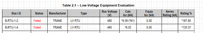

I know when I performed studies, as a gear manufacturer, I was never provided with end use equipment ratings. Typically the third party equipment hadn't been purchased yet or, more likely, the electrical contractor just wanted the study done quickly so the service equipment could be ordered so they didn't provide enough information to study down to branch circuits.
To answer all three of you. This is my opinion based on experience. First off, I am referring to new construction. The elevator is a fairly easy one because I have done several, and my experience is that at least Kone, and Otis only have SCCR of 5000, they don't make their equipment with a higher SCCR and their standard instructions tell you this. Second, the Electrical Engineer and tell and order of magnitude AFC at points on the system, based on generic transformer impedances, conservative wire lengths, etc. Joe, I can pull up 20 sets of bid plans right now that include an AIC rating for fully rated distribution systems. Ron, in most cases the MEP's are all one engineering firm. THEY specify the equipment. If they didn't specify equipment with a high enough SCCR for the system designed by their brother engineer, that is their problem. If they cop out and require the mechanical bidder say, "provide SCCR as required" they are basically making the customer pay for equipment that has an excessive SCCR, because if the engineer can't make an educated estimate of the SCCR, then the mechanical estimator certainly isn't going to. Jim, my Engineer. who is out of Jacksonville specifically asks for any cut sheets for equipment that is 60A or larger and available. Here is a snip of a report from a recent report that I am now dealing with.

I have never seen an engineer fix this problem. (unless they are getting paid) It is the 3rd party equipment suppliers responsibility to purchase the correct SCCR rated equipment. This is always an issue with chillers and large RTU/AHU's. It is the job of the engineer to inform the other trades of the AFC at equipment connection points prior to equipment being purchased. As far as equipment being rated at 5K that is just the manufacturer saving money and typically other SCCR rating are available. (At least this is what I have found to be true with equipment)

THIS is where the rubber mees the road in my post. The Electrical and the Mechanical Engineers work for the same company. The specified HVAC units doesn't meet the AIC requirements of the design ON THE PERMIT Plans and Specs. The mechanical contractor supplies the equipment as specified, the electrical contractor installs the system per plans and specifications. Who is responsible when the Short Circuit Study report comes out and looks like the one I attached above?
