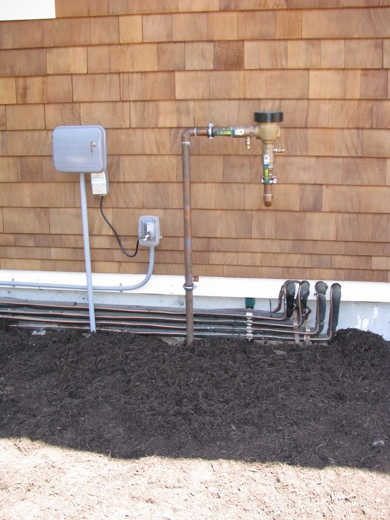

One of the houses I looked at today had this situation.
The building in the picture is a detached garage. The waterpipe supplying the building is copper, but it is installed inside of a large (2 ft diameter) metal drainage pipe installed between the two buildings...there are other utilities in the same drainage pipe.
In the picture, you can see a copper pipe outside that is supplying the lawn sprinkler system.
Assuming there is more than 10' of copper in contact with the earth, is this sprinkler pipe now the electrode?
