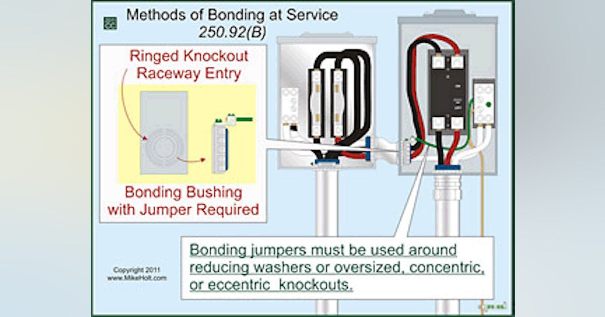

Hi all, our typical service is a few sets of 4"C so they are run into the service panel via punched openings. They're often in rigid conduit, and use a compression fitting to secure them to the main panel/switchboard. I have read 250.92 (B) several times and can't understand if a 'regular' compression fitting is acceptable or needs additional bonding. (B)(3) seems to mean that they ARE acceptable since we make them up tight.
Does the threaded part of the fitting with a regular locknut provide enough bonding?

We're confused by (B)(3) which seems to explicitly ALLOW these for bonding the service raceway "threadless couplings and connectors if made up tight for metal raceways and metal-clad cables". (2024 NEC)
How are we mis-reading/understanding this?

It's confusing because the first part of 250.92(B) says that standard locknuts cannot be used. The standard locknut even with a threadless connector can only be used for the mechanical connection.
250.(B) Method of Bonding at the Service
Bonding jumpers meeting the requirements of this article shall be used around impaired connections, such as reducing washers or oversized, concentric, or eccentric knockouts. Standard locknuts or bushings shall not be the only means for the bonding required by this section but
shall be permitted to be installed to make a mechanical connection of the raceway(s). Electrical continuity at service equipment, service raceways, and service conductor enclosures shall be ensured by one or more of the following methods:
1. Bonding equipment to the grounded service conductor by an applicable method in
250.8(A)
2. Connections made up wrenchtight using threaded couplings, threaded entries, or listed
threaded hubs on enclosures
3. Threadless couplings and connectors if made up tight for metal raceways and metal-clad
cables
4. Other listed devices, such as bonding-type locknuts, bushings, or bushings with bonding
jumpers

The bolded sentence doesn't say that standard locknuts can't be part of a compliant bonding path, just that (two) standard locknuts shall not be the only means of bonding. A threadless connector is a listed fitting that uses a locknut as part of the fitting; it does not consist of "only" standard locknuts.
A threadless rigid connector is listed to UL Standard 514B "Conduit, Tubing, and Cable Fittings," while a bonding bushing or locknut is also listed to UL 467 "Grounding and Bonding Equipment." Both standards require what UL 514B calls a "current test" and UL 467 calls a "short-time current test." Up through conductor size 3/0 Cu and trade size 4", the test requirements of the two standards are identical, as far as what current is required to be withstood for what time period. (For 4" that's 5050A for 9 seconds). UL 467 has higher requirements for equipment intended for use with conductors larger than 3/0 Cu, while UL 514B's requirements do not increase for sizes beyond 3/0 Cu.
So it seems to me that a threadless connector, in conjunction with the provided locknut, does meet the requirements 250.5(B)(3), and is not prohibited for 250.5(B) bonding by the clause that excludes "standard locknuts" as the "only means" of bonding. Moreover, in terms of actual test performance, up through trade size 4", a bonding bushing listed to UL 467 has not been tested to a higher standard than a threadless rigid connector has been.

FWIW, this article agrees that a threadless connector suffices for service bonding for terminating a metal raceway to a metal enclosure, per 250.92(B)(3):
"The NEC gives you the choice of four methods for ensuring electrical continuity at service equipment, service raceways, and service conductor enclosures [250.92(B)]: . . . (3)Threadless fittings. Terminate metal raceways to metal enclosures by threadless fittings (if made tight)."
I think Mike Holt agrees, although his comment "(3)Terminate metal raceways to threadless fittings" is a bit more terse than the above.
