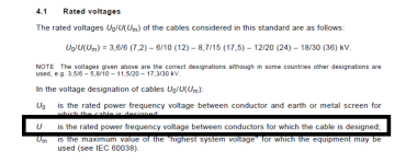

For this service voltages I believe that cable 18/30 (36) kV should not be used even designed for Umax=36 kV.
Also in most cases earthing regime is IT.
In this way may be the best technical solution is cable 26/45 kV and not use 18/30 (36) kV cable.
