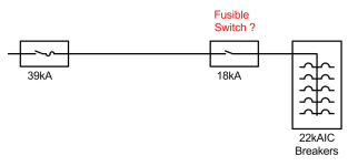

Do I need a fusible switch, if a typical non fusible is only 10kAIC. 39kA and 18kA are available fault currents?

@Jraef, so if i use 100kAIC fuse on my first switch then rating on my NF switch will be 100kAIC? just want to make sure i got it right. Thank you!
Correct. Assuming the NF switch has a “series rating” with fuses, those fuses don’t have to be IN the switch, they can be upstream.

SCCR is always dpecified as being at the incoming/line side terminals of a device.
No issue, if a manufacturer not listed such combination, a PE can certify the combination
No, they cannot.
The NEC makes no provisions for field engineered SCCR series ratings of non-fused switches.
The only NEC allowed engineered series ratings are for circuit breakers without instantaneous trip functions.
But op asking to replace with 100kA fuse in fusible switch marked with 39kA!
There is no fusible switch rated at only 39kAIC.
The OP needs a 39kA minimum fused switch to protect a non-fused switch which has 18kA available. The manufacturer literature says an upstream fuse can series protect a downstream switch up to 100kA, so the OP's installation meets the NEC, as long as fuse rejection clips (disallowing 10kA fuses) are installed in the upstream switch.
