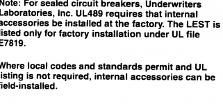

Hey guys ran into a bad shunt trip breaker for an elevator (1 pole was bad). The local Square D house told me an FA frame 3 pole 70 shunt trip was obsolete.
I ordered up a 3P 70, shunt trip from the local house, and got this.... GE TED series with a field install shunt trip kit, and the enclosure. Long story short the shunt trip isnt supposed to be a field install, and the kit is more a replacement part.
My question is this, does anyone know of a way to use a standard breaker, and have the fire alarm trip a relay or contactor (thinking 3-wire stop start circuit, fire alarm is the start, and the stop being manual would restore the elevator), as there seem to be supply chain issues with a 70 amp shunt trip breaker. If there is, MAYBE I can coordinate with the elevator contractor, and he can do this part.
Just looking for some ideas, as I am kinda upset with the supply house, this is a bid job, and the customer would like his elevator back......
Thank you in advance
