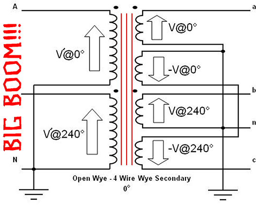

An Open-Wye Open-Delta real world bank also uses two cores to convert from a system of two phase-displaced voltages to three phase-displaced voltages.
Another real world application is the Open-Wye to 4-wire Wye connection. It uses two cores but takes advantage of the center-tap and the real world fact that the negative signs are also physical realities. It uses these real world minus signs to create a real world set of three phase-displaced voltages.

As I stated in my previous post, the use of the negative voltage is actually used in a real world transformer connection to take an open wye set of two phase-displaced voltages to produce a 3-phase wye set of voltages. It does this by using the negative voltages from 1/2 of a center-tapped winding. This negative voltage is really there and we do not have to provide a second isolated core for this to be valid or used in a real-world application. This negative voltage is simply a physical reality, not just some math trick. If it were just a trick, we would not get the 4-wire 3-phase wye that is used in the real world. See the following utility transformer diagram for clarification:
As you can see, our source has the 0? voltage (voltage A) and the 240? voltage (voltage B) but is missing the 120? voltage. On the secondary side, we have our a & b voltage by using the same orientation as the primary. We use the negatives of the center-tapped secondary voltages to get the c voltage = -V@0? -V@240? = V@120?. The load does not care that we only used two fluxes, and for the purposes of identifying the system of voltages, neither do I.

As I stated in my previous post, the use of the negative voltage is actually used in a real world transformer connection......
Again, you are trying to deliberately mislead the readers of this thread. Why are you showing a 3-phase system when the discussion is about single phase? Can you not win an argument without deception? Stick to the facts of a standard 120/240 volt system please.
Oh by the way, just in case there are those that don't fully pick up on why your 3-phase diagram example is so deceptive to the typical reader of this thread, I put the critical and missing piece back into your diagram. :grin:
The open-wye example went to refute your premise that to have the minus sign you need separate cores. You also make the erroneous statement that there were no real-world applications that made use of this minus sign.
I don't see where that adds anything significant. Care to elaborate on the deception? Maybe your missing piece is like the missing part from Games You Can't Lose by APC :grin: :

An inversion is a minus sign. A phase shift is a time delay.
My revision is:
The counterpoint, is that for a single frequency system, a sine wave produced by a 180? delay and a sine wave produced by inversion do not simply look the same, they are _indistinguishable_ and completely _equivalent_.
I agree that there are different methods that will get you to the given output, and that these different methods will have different mechanics, and (given the real world) different flaws. But in the idealized case the _outputs_ are equivalent, and if the outputs are equivalent than for anything which looks only at the output the internal mechanics are irrelevant.
Furthermore, since the outputs are equivalent, I can use either method to create the output for either application. Say I need a time delay of exactly 1/2 cycle; I don't have to invest in a delay line; I can use a simple inversion.
Because the outputs of the different mechanisms are the same (again, in the idealized case), then it is reasonable and correct to use names derived from either mechanism in order to describe these outputs. IMHO it is just as reasonable to say '0? and its inverse' as to say '0? and 180?' to name the legs on a single phase supply.
-Jon
What he said:
-Jon
In other words,
-120V @ 0 = +120V@ 180
Either value will provide the same result.
We of course assume pure sinusoids and linear circuit elements. If these assumptions cannot be made, then we cannot use phase angles anyway.
Still single phase though!
