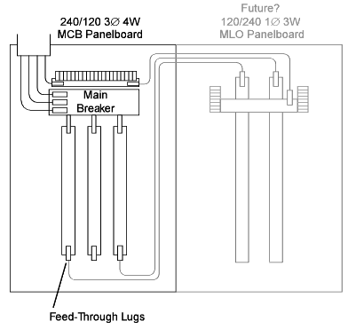

I'm leaning in the same direction as Jon and Chris... with the additional reason of professional level workmanship. Any attempt equipment-wise to get around running a full boat 200A feeder is not going to be any more economical AFAICT.
However, I would go with the 200A 3? MCB panel but with the stipulation that it have feed-thru capability for the addition of a 1? panel, either now or in the future...
Okay, I'll need to full-size all three phases, and use a 3-ph main-breaker panel. While the HVAC compressor is the only 3-ph load presently, there will also be a few 240v, 1-ph loads (water heater, an in-wall space heater, a kiln) so the high-leg won't be quite so unused.
Most of the store load will be 120v loads, such as the furnace/air-handler, four fluorescent lighting circuits, one for utility room and bath lights and fans, one for common-area lights (4-6), and 8-10 receptacle circuits.
As long as I have to spring for a 3-ph panel, I see no advantage to using two panels over one large one. A 42-circuit panel will leave plenty of expansion room.
Since this isn't residential, nor 240/120v 1-ph, I have to use full-size conductors. However, I still have one un-sure-ity: service conductors need only be sized for the calculated load (230.42(A)), yet must be protected at not more than their ampacity (230.90(A)). Is there a contradiction?
If not, then the breaker determines the size. In this case, 3/0 cu or 4/0 al, right? Table C9 (and this handy-dandy calculator) tells me that, even with a full-sized neutral, I can use 2" PVC. Unless I'm missing something, this all looks right, yes? Thanx!
