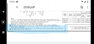

Sorry for the second pic.

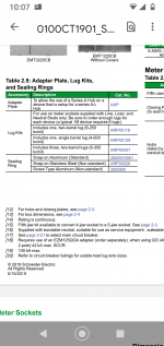

I meant to post up a pad kit and then double barrel 750 mcm lug.
Using the pad kit eliminates the factory lugs and allows you to use a double barrel larger lug for the 700.
Again sorry
Something like this.
You could also use a four hole and go with four sets 250. And or other configurations. Check with square D rep on what they can supply with the pad kit. Pad kits are cheap.
